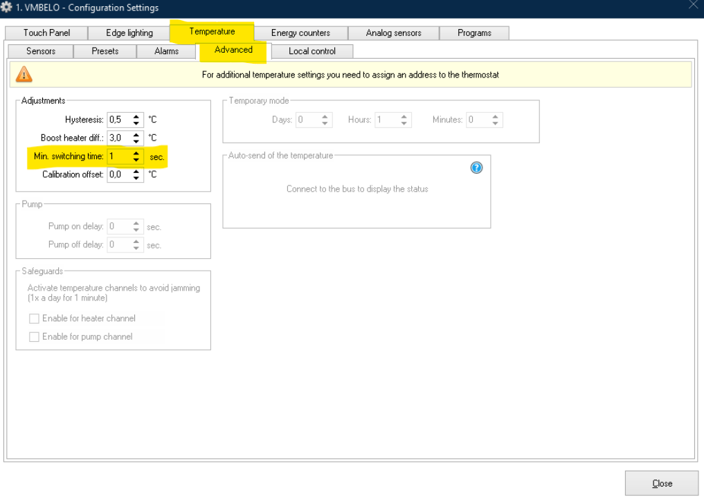

Can you change the "Min switching time to 1sec. (see picture below).
This in the configuration settings of VMBELO, where the problem “booster channel stuck” occurs.
Possibly after adjustment, this will solve your problem.
Best regards,
Velbus Team
hi - this indeed seemed to solve it …
