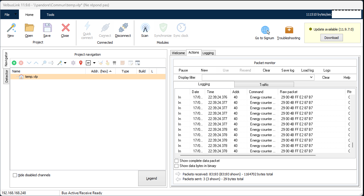

I don’t know if it’s related to this post or not (then I would open a new one) but I use velserv (jeroends TCP server) on my installation and it works great. But since few months, I can’t connect to my network with VelbusLink: it freeze.

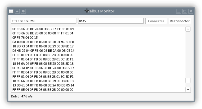

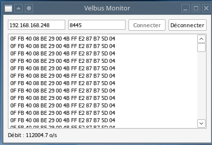

When looking with the well known analyzer ‘Wireshark’, I can see lot of [TCP ZeroWindow] emitted from the VelbusLink PC. The communication seems to saturate… Has someone this problem?

I suspect it, because the problem occurs few months ago, without any change. I’ve unpowered it (from Velbus side) but it changes nothing. On the Velbus side, all modules are blinking sometime on RX led, so my BUS isn’t concerned (in French, “Ouf!” :grin: ).
[Edit 20 minutes after] it’s ok again!]
The VMB1USB needs a full reset (power down on each side).
