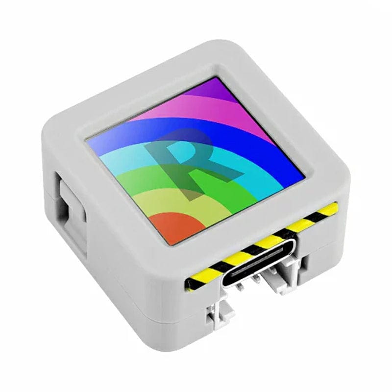

Do you mean hardware like this???
Or their tiny unit?
LOL, yes I did.
Either of those two approaches would get you most of the way there.
Just missing ethernet.
I would not like to rely on WiFi… Velbus+Velbuslink is real-time enough that normal WiFi can cause problems that Velbuslink might not handle.
ESP32 does have ethernet support but most the devkits do not have the little bit of extra hardware required (PHY+magjack)… probably because the WiFi is so popular.
Oh… I see there IS a PoE module for the Atom S3 also…a bit pricey though.

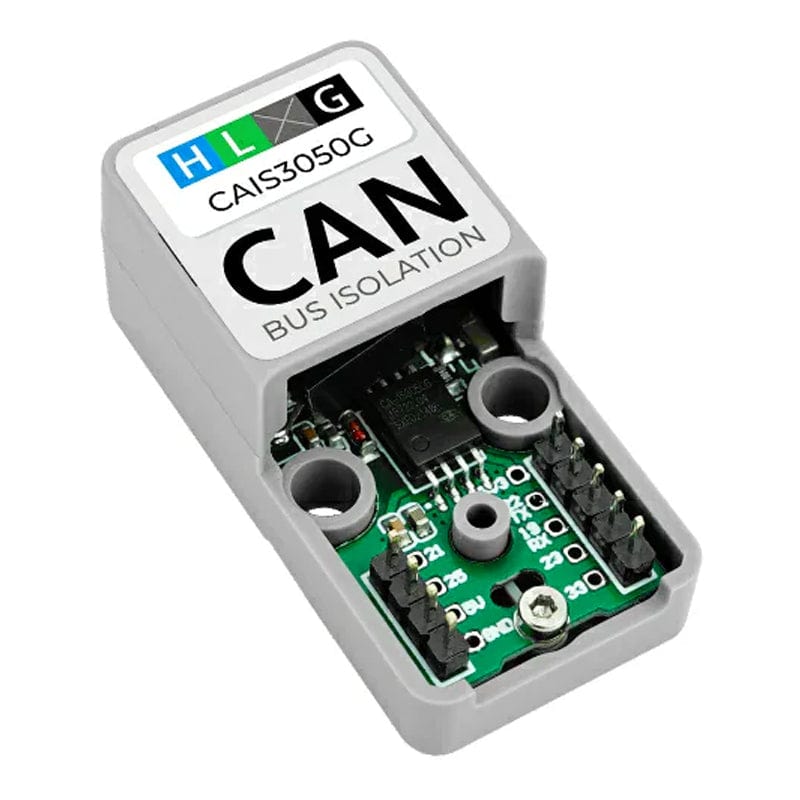

With a few software tweaks and some added CAN support those 3 modules combined could definitely run an adapted velserv without Linux or SD card.

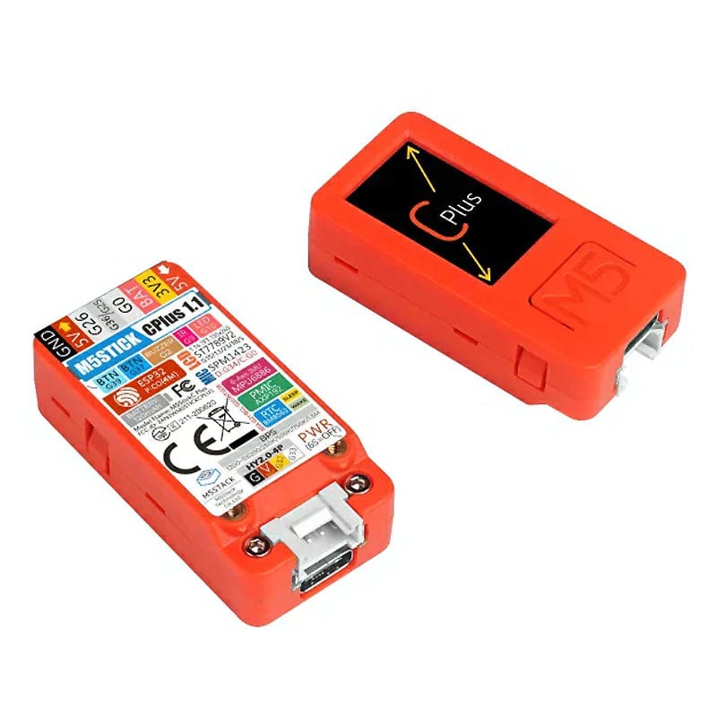

The M5Stick series does have an RTC onboard :wink:

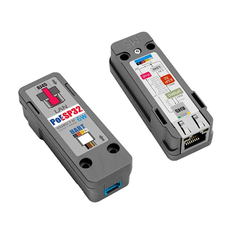

Indeed there is a M5 POE module:

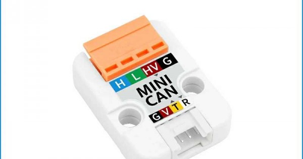

And a smaller CAN also exists:
oh, it looks like the M5Stack PoE addon is a whole other ESP32, interfaced to another M5 ESP32 module over a serial port like a modem… which is OK for short IoT messages but probably won’t work well for Velserv.
