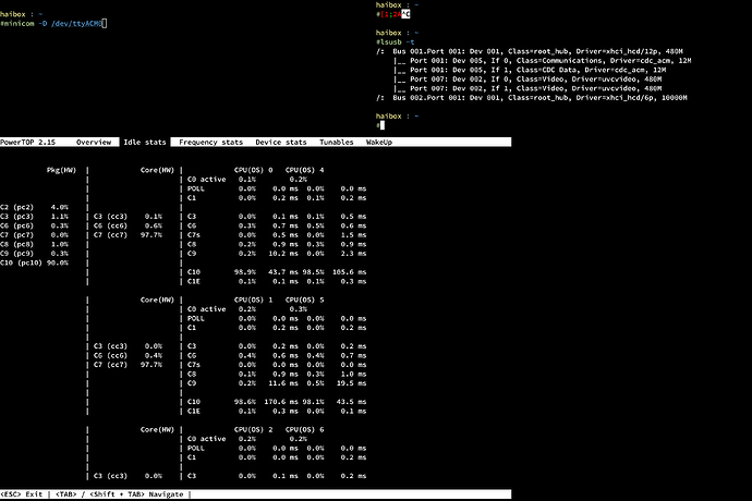

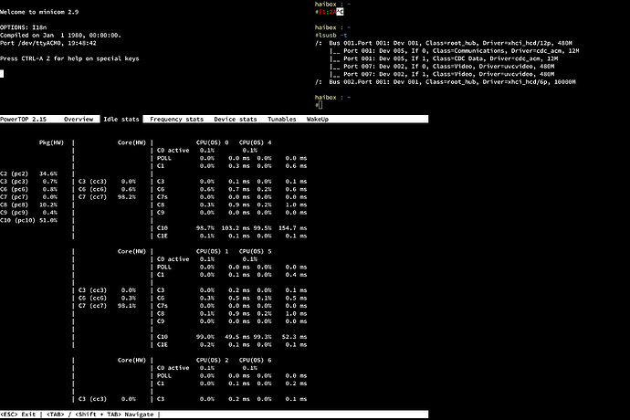

How super weird, huh. Getting the entire package be asleep for 99% of the time sounds really amazing – this would be almost as good as putting the machine to S3 sleep. Best I’ve seen was, like, pc10=92% – on my laptop after it has just been booted (with networking disabled) up and only showing some idle terminal windows and a powertop. I realize some of the residency loss could be due to having to drive a display, but yeah, the following screenshots is what I see on the laptop (2nd screenshot with VMB1USB which has the bInterval = 2 connected):

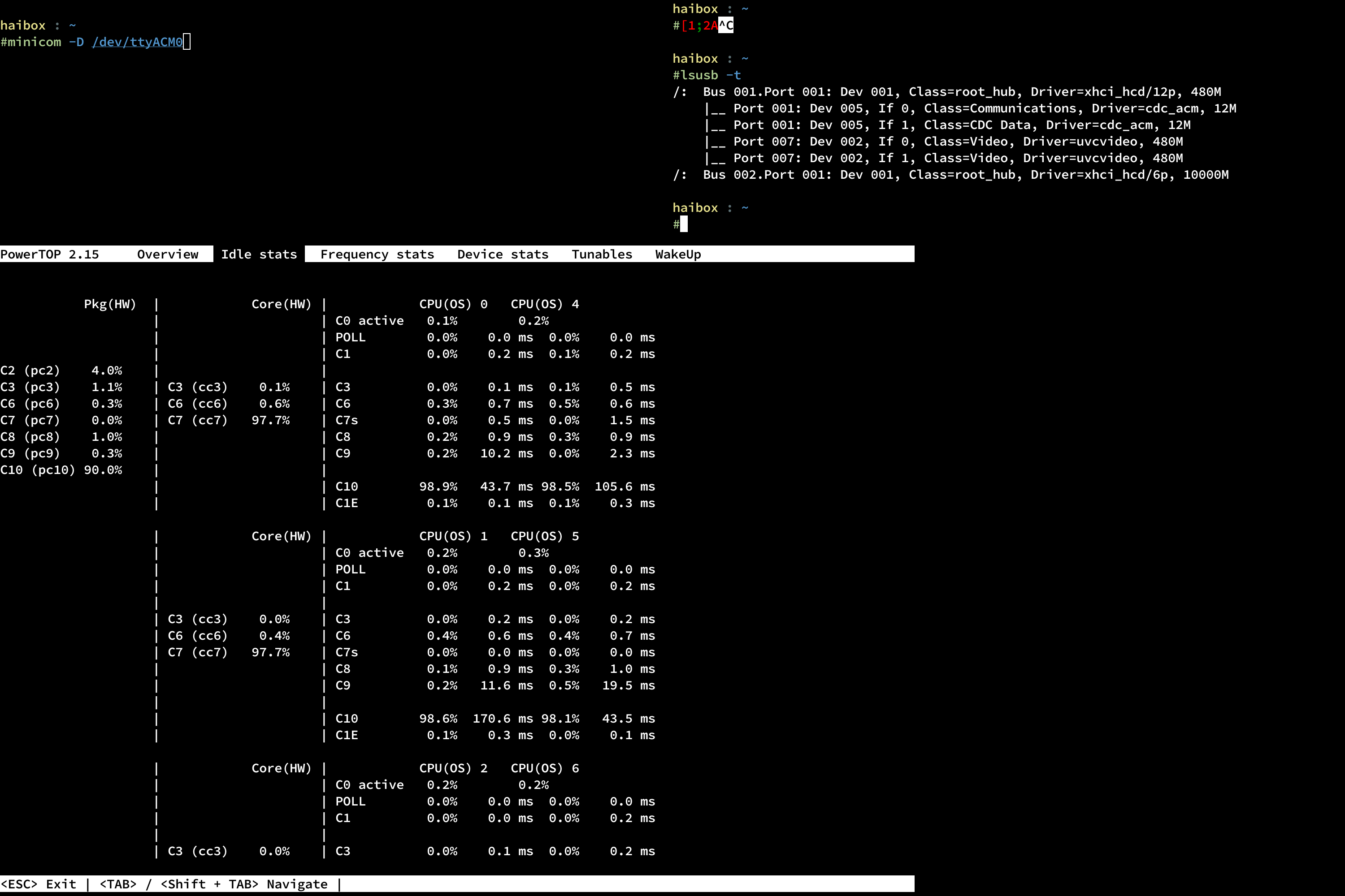

pc10 = 90% when idling (without minicom running):

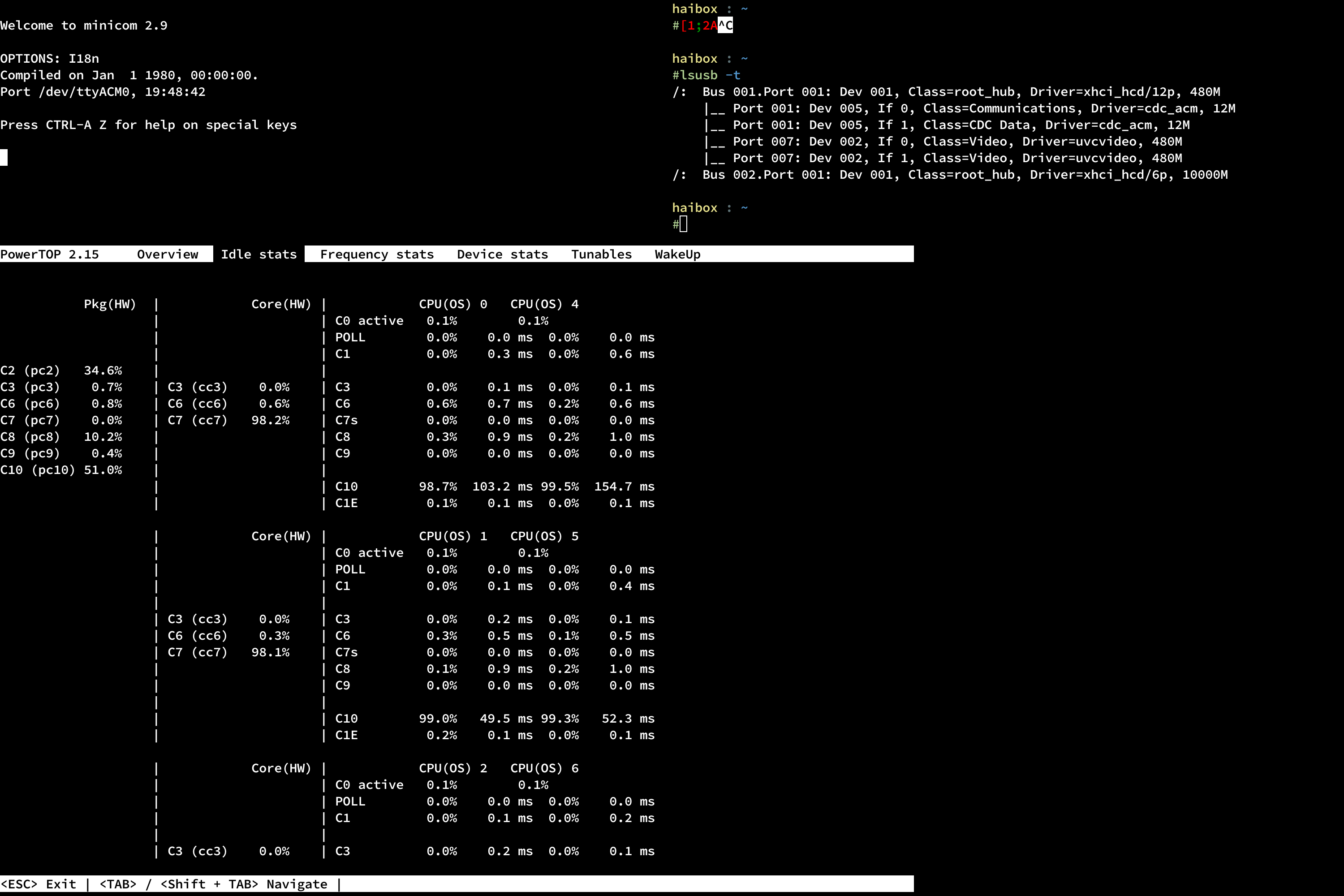

Down to pc10=51% with minicom running:
