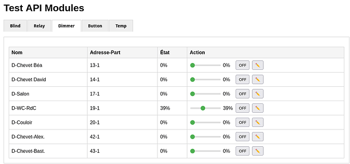

But this time, it’s really better, and it could be tested as an alpha version (I still have few work with dimmer’s status) and I’ve got a static page to test it. I’m creating a kind of API that would let other developers to use my software.
The project is on GitHub : https://github.com/droumanet/ArVel
Here is the static HTML page :

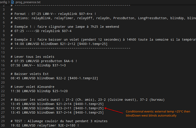

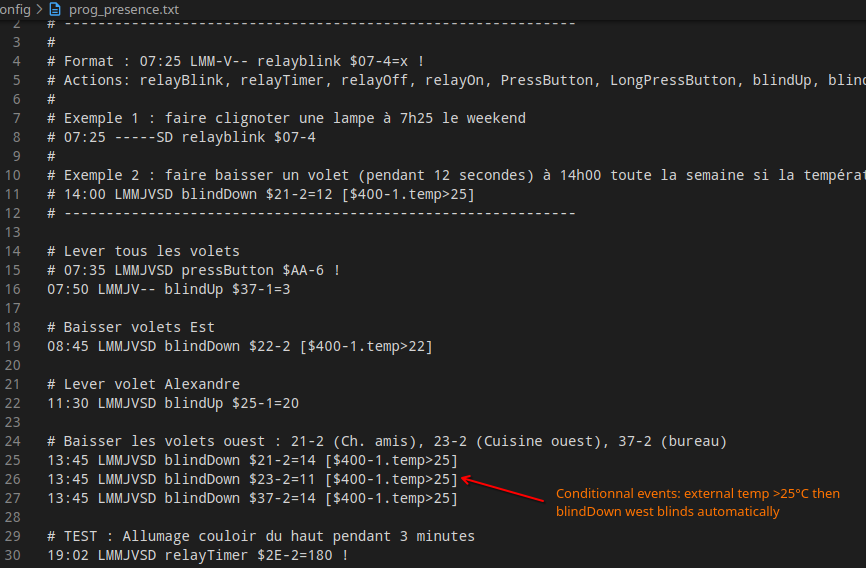

Programming event is a simple text file for now, but easy to use

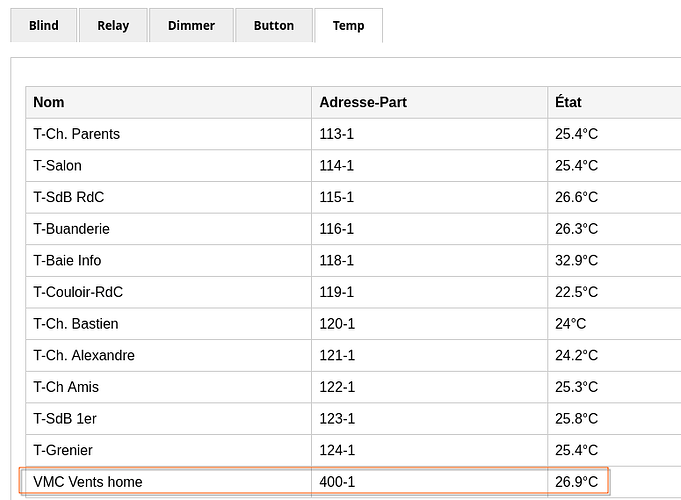

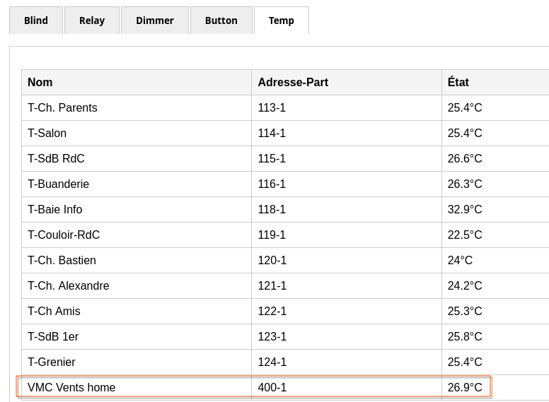

I’m playing with teleinfo (french Enedis protocol on their counters) and my VMC (ModBus over Ethernet) : a simple Python’s code that send datas over TCPIP/UDP protocol.

Thanks. Now I’m able to manage dimmer on VMB1DM or VMBDME/VMBDMI (seems to be compatible with VMB1LED, because using only $EE and $07 functions only, for now).

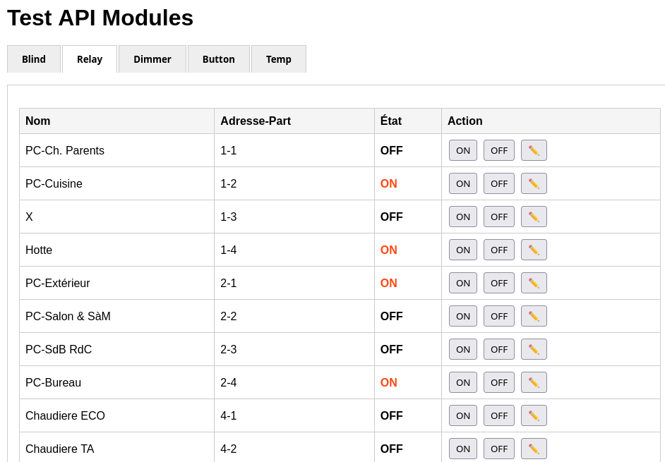

Again, the static file (index_listes.html) is just for easy managment and testing (was IA generated at 90%). You should have a mariadb services of course (little use at present time, but would be use for status changes, later, and some graphical usage).

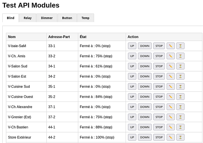

I really hope the API Rest approach would be a better way to manage Velbus network than direct message and I’m ready to listen at new ideas or push request :slight_smile:
My main concern is about VMB2BL channel managment: who have had this idea to use 0b11 and 0b1100 to select channel, rather 1 and 2?
