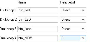

I haven’t tested the idea out, but one way you could try approaching this is to use a cancellable action, such as “inhibit” or “force off” (related actions are “cancel inhibit”, “cancel force off”) for the first minute, and then kick off a virtual button/relay channel to invoke its actions after a “timeout” action of some sort expires. This would ultimately apply regular “off” to all the channels and cancel the inhibit/force off. Cancelling the “all off” is then figuring out how to cancel the timer and invoking the cancellations.
That said, maybe there’s a simpler solution: can you configure the button to only react to long presses? Would pretty much rule out accidental activations.
In most cases for all off functionality, we suggest to put a 2 second reaction time or 3 second reaction time on the button (and saying that on the panel)
Sometimes the best solutions are the simple ones :wink:
Might be a stupid reaction, but I had the same problem.
I solved it by simply putting a 2 second delay on the all off function.
I’ve put a delay on it for now… seems to be going better
