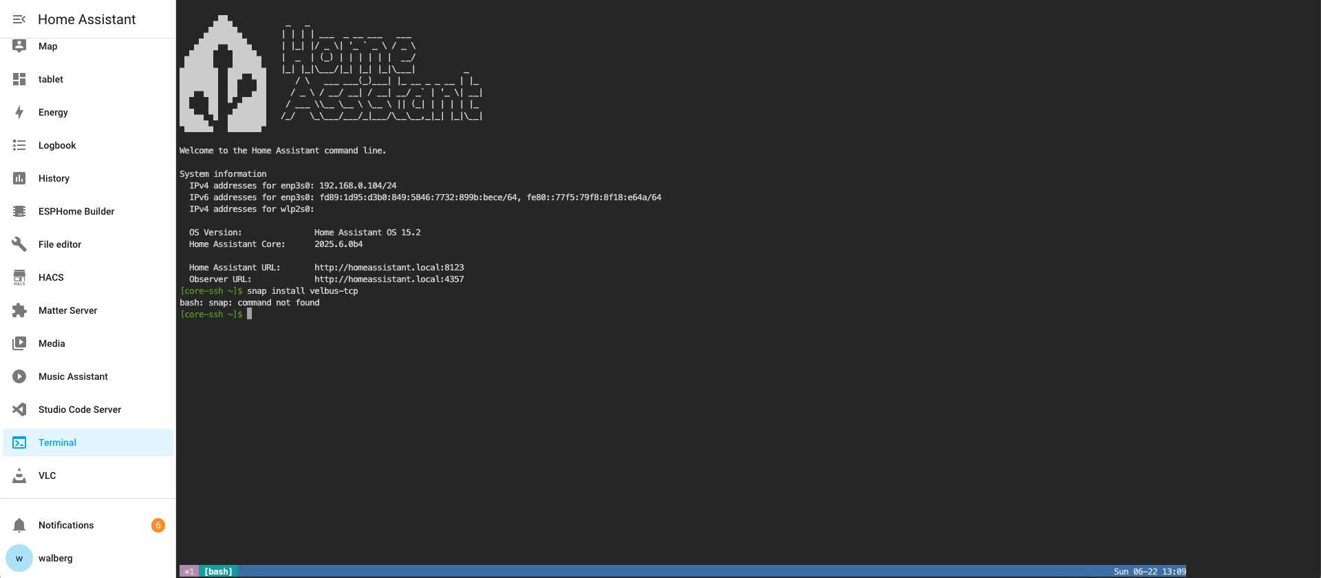

Hmm. i don’t know what version of linux is on my NUC. i did a few years ago a Home assistant install with i think a linux distribution
i tried to put the snap install command from the terminal (but maybe i must first change to another directory) snap is not reckognised.

too bad it seems the command line is a util of HA, not from the linux. And i dit: ha network info
Then i seems there is indeed a docker, there is the common adres what i use on a browser with 192.168… but also a range (i think for the docker) from 172…
the Ha Os i got is:
Generic x86-64
