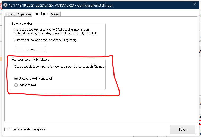

Great, so you would assume that my light is on, as that’s what the Dali module returns, however: it’s not…
The Dali module is configured to have a fade of 0.7s. Not sure if that has anything to do with this.
Can this be fixed?
Some context:
I’m an owner of a Velbus installation with a VMBDALI-20 module, which I want to intensively use with both Velbus (in combination with velbus push buttons) and Home Assistant (for more complex automations). In home assistant when I turn back on a Dali light, it remains off; however the UI indicates the light is on.
