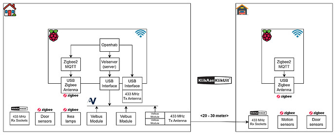

Now the solution is (and has been working for 1 month):
  • Zigbee2Mqtt bridge on the RPI for 2 Aqara Zigbee sensors (door + motion) + Zigbee antnenna. Save on cabling in the garage. Just 2 battery powered modules.
  • 2x 433 MHz controlled power sockets. There is this Dutch “KlikAanKlikUit” series of 433 MHz modules and the transmitter is in the house, connected to the main RPI. But range is enough to trigger the whole neighborhood :wink:
This turned out the be the most efficient for me. Especially the battery powered part of it saved a lot of time.

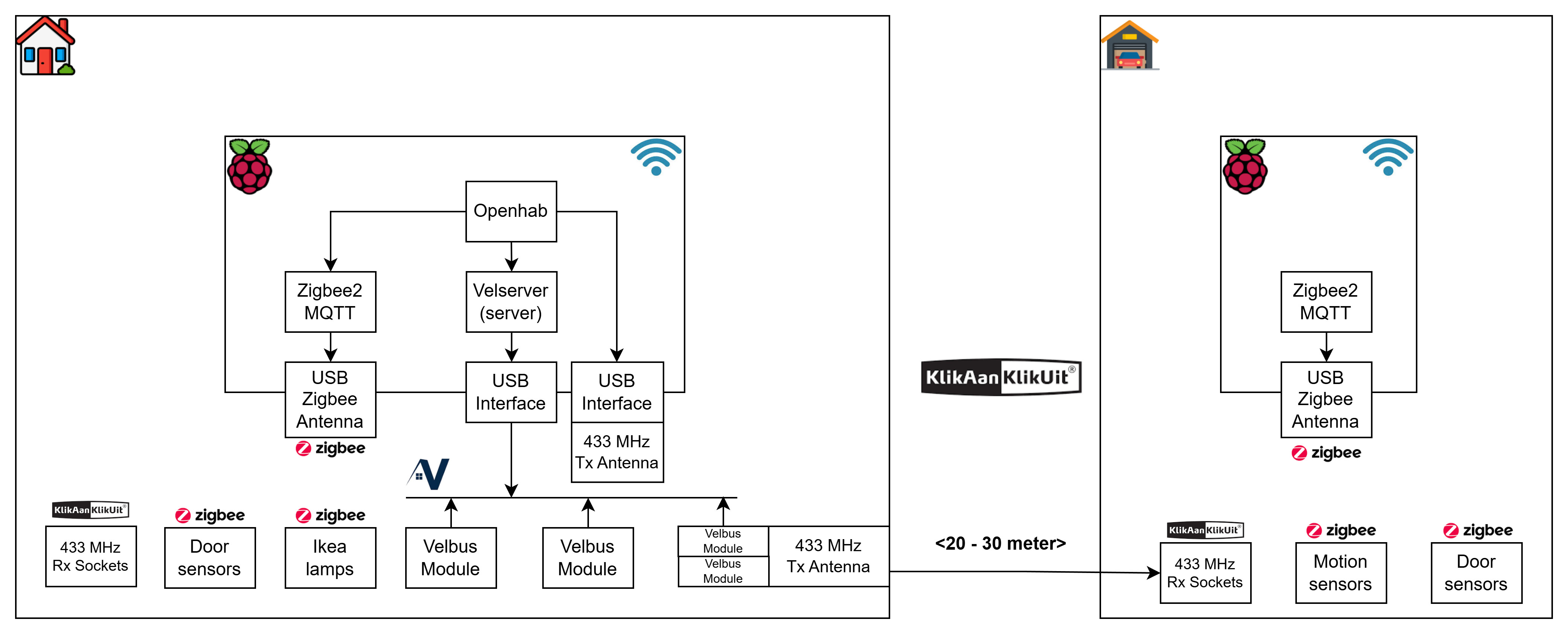

Schematic of the current layout:
Note:
  • The house already uses a large number of these “KlikAanKlikUit” 433 MHz modules so that was already working.
  • The house also already uses a large number of Zigbee devices (mainly IKEA lamps), so that was already working too. Just had to clone that setup to the garage.

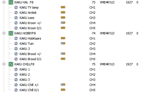

I just concluded I never shared the most actual layout of the Velbus domotica in our house.

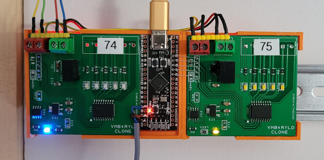

The last layout I shared had the 433 MHz transmitter connected to the PC running OpenHab. Making this system sensitive to crashes of the PC.
So I made 2 “clone” VMB4RYLD Velbus modules connected to another 433 MHz Tx module. Now I have the envisioned robust layout where the Velbus will continue to work, even when the PC / RPi is down, or I mess up the OpenHab rules.
And it has the long range to the garage to switch on the garden lights.
Left & Right 2 clone modules. In the middle an STM32 handling the KlikAanKlikUit data Tx.
Each module has 5 channels:
3 x On/Off
1x Dimmer Up/Down (4 steps)
1x Dimmer On/Off
So this combination of the 3 modules can do 9x 433 MHz power sockets & 3 dimmable lights.
And it solves the problem of not having any Velbus wires installed in the living room. I just plugged in 4 KAKU sockets, and the lights are controller by the Velbus straigh away.
