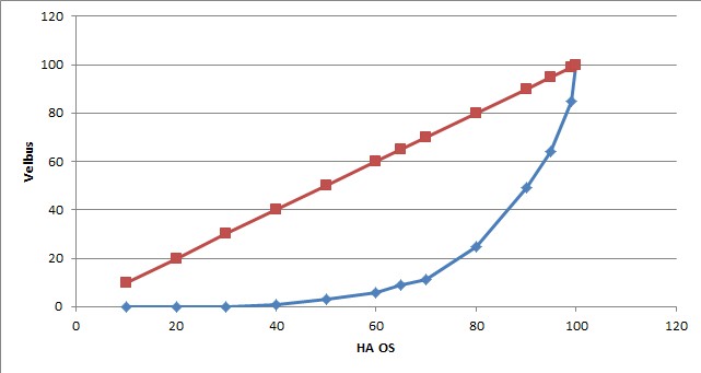

Hallo
Module: VMB4LEDPWM-20
Wanneer ik in Home Assistant een “brightness_pct: 80” instel, dan zie ik in VelbusLink slechts 25%
Eender wat, lager dan 30 in HA, VelbusLink blijft op OFF
Een paar ander waardes hieronder: HA; VelbusLink
50; 3 – 70; 11 – 90; 45 – 95; 64 – 100; 100
Dat geeft een héééél exotische XY-grafiek die ik jullie zal besparen.
Waar komt dat verschil vandaan ?
Bedankt voor jullie inzichten

Have you posted this on the HomeAssistant forum and seek assistant from the integration team?
If it’s a very specific curve, I could guess at the reason, but you say your graph is exotic. Does this mean you hadn’t spikes & troughs in it?
I think the Dev fixed an issue with the lookup table from an early integration.
Are you running the latest version?
FYI
Some Velbus dimmers don’t follow a 0 to 100% in decimal.
Newer dimmers are Hex. 0x00 to 0xFF
Meaning the Slider value needs converting from Dec to Hex.

Hi,
Latest version of what? HA, module, VelbusLink ?
Since it’s not a life-threatening situation I didn’t post anything on HA forum.
I just wondered where that difference came from
Range 0 to 40% in HA OS can’t be used since the light remains OFF

That curve looks familiar
Did you get to page 6 of the protocol doc?
(I’m fairly sure the Velbus dev for HA has addressed this issue already)
