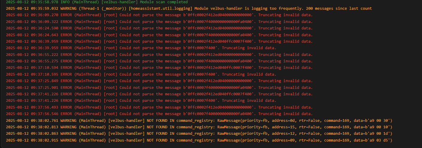

I see issues every second in my log file. The warnings are related to velbus, the errors I dont know:
2025-08-12 09:38:02.761 WARNING (MainThread) [velbus-handler] NOT FOUND IN command_registry: RawMessage(priority=fb, address=0d, rtr=False, command=169, data=b’a9 00 30’)
2025-08-12 09:38:02.813 WARNING (MainThread) [velbus-handler] NOT FOUND IN command_registry: RawMessage(priority=fb, address=15, rtr=False, command=169, data=b’a9 00 10’)
2025-08-12 09:38:02.863 WARNING (MainThread) [velbus-handler] NOT FOUND IN command_registry: RawMessage(priority=fb, address=12, rtr=False, command=169, data=b’a9 00 1d’)
2025-08-12 09:38:02.915 WARNING (MainThread) [velbus-handler] NOT FOUND IN command_registry: RawMessage(priority=fb, address=09, rtr=False, command=169, data=b’a9 03 d5’)
anyone came across something simular?

To me it seems like there’s a module (VMBPIR-20) that’s not fully supported and hence throwing those warnings. It’s the community Velbus integration that logs these messages.
if thats the case, you can log it here:
GitHub - cereal2nd/velbus-aio: Velbus Asyncio
How do you know it’s the pir sensors?
Ah, based on the address. Gotti, overlooked it… sorry. I will log it. Thank all!
