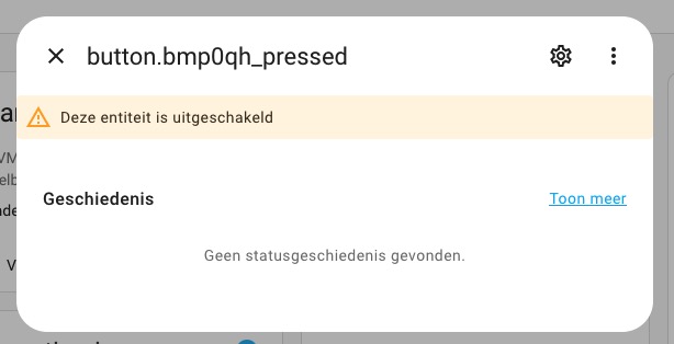

Even the entities > 62 entities on Home Assistant like Alarm1 2 3… button 1 2 3 etc but when i want to pick one to test if the button is hit… No! the identity is disabled!! all 62? how to enable?
See picture: The identity is disabled, on Dutch: de identiteit is uitgeschakeld!

We’ve also noticed you’re struggling with some basic Home Assistant features, such as disabled entities. We strongly recommend taking a bit of time to explore and understand Home Assistant more in depth — this will help you move forward faster and avoid unnecessary frustration.
