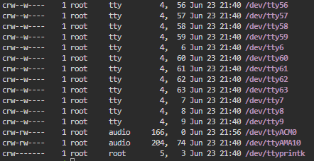

Or insufficient permissions. ttyACM0 is owned by root:audio with permissions u+rw,g+rw. If they’re trying to run velserv as user other than root or somebody in the audio group (the fact that ttyACM0 gets put with audio group at all indicates some wonky udev rules) they’d see this sort of error.
Can always ask nicely with some sudo for a try.
