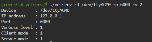

So now I think I managed to get the VelServ complied and Running on the home assistant os. I had some issues installing gcc but it seemed I had to use apk add instead of apt-get.
However, if I now run
./velserv -d /dev/ttyACM0 -p 6000
I get no error or whatsoever.
I assume it is Running as I get a result when I try pidof velserv
However, if I try to setup TCP in the Velbus integration using 127.0.0.1 and port 6000, it tells me I can’t connect.
Doing the same in VelbusLink Also won’t work.

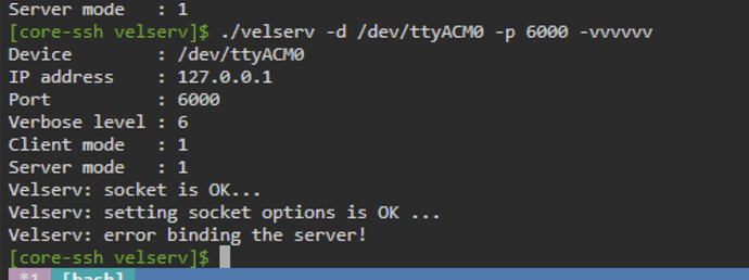

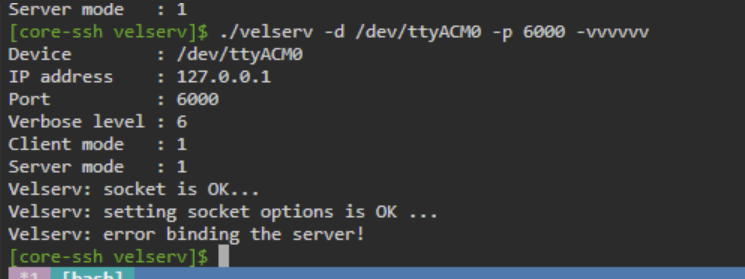

It doesn’t connect.
But I seem to get why. If I run the VelServ command with debug option as requested here, I have some more information:
I’m planning to give it a try using a different Pi to set up the Velserv
Okay
So that’s a step forward.
The million dollar question is
“Is your operating system definitely binding the USB device to ttyACM0?”
If you list your /dev folder, is ttyACM0 in there?
Or… Could it be that your OS have bound the Velbus USB to something else?
For example ttyUSB0
Try this command and see what happens
ls -l /dev/tty*
