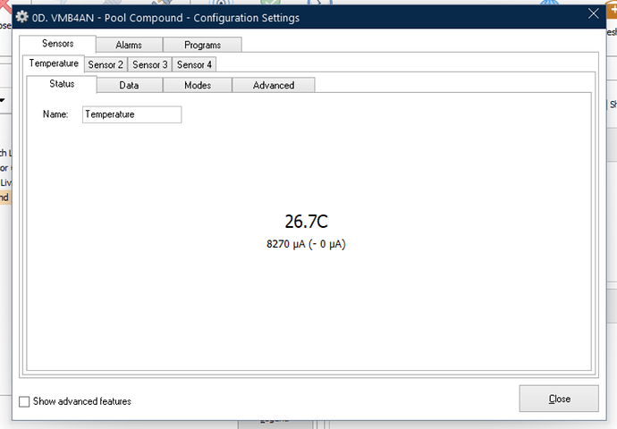

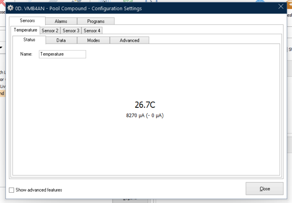

4.20mA temperature sensor is online, thanks to this link by @RCZ . The 4…20 mA connection took me by surprise, I was expecting Common and Input1 to be used, but it’s 24V on the + side and Input1 on the minus side.

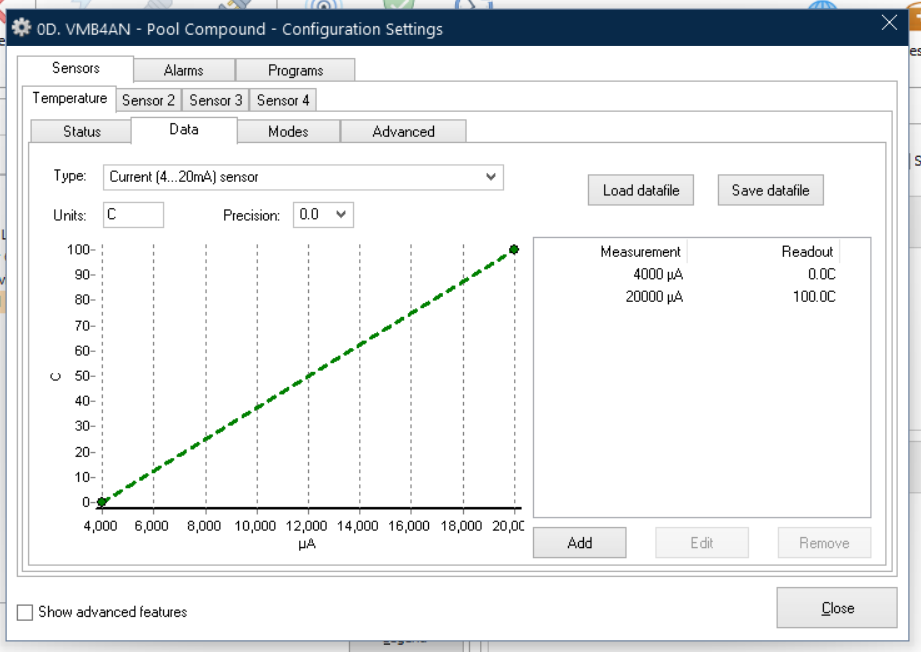

I didn’t do any accuracy checks as I don’t have a better device yet. The sensor setting and the calibration curve (or a line in my case) is defined in a text file with a very simple format:
[Info]
Name=Temperature
Manufacturer=
Description=
SensorName=Temperature
UnitCharacter=C
Precision=1
SensorType=1
[Data]
4000=0
20000=100
The next on-line will be 4…20mA ultrasonic distance sensor. :nerd_face:

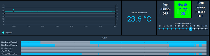

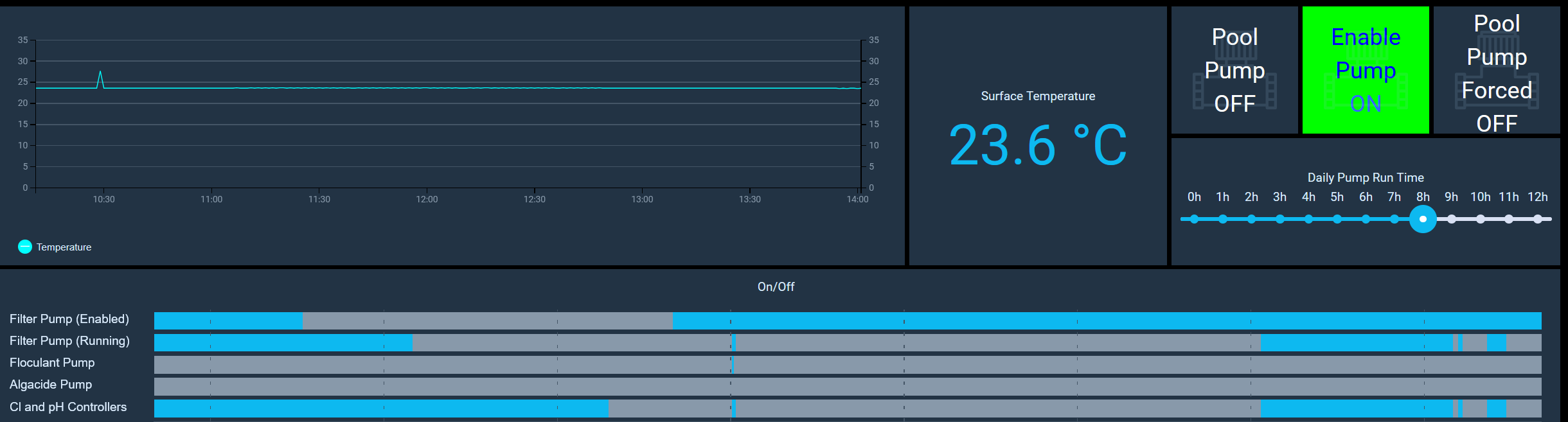

The openHAB side of velbus pool control system.

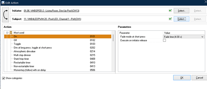

VMB4LEDPWM-20 arriver today and it’s now connected to the system. It controls a white 12V LED 45W strip. Power from a 60W PSU. Dimming is smooth as butter. :heart_eyes:

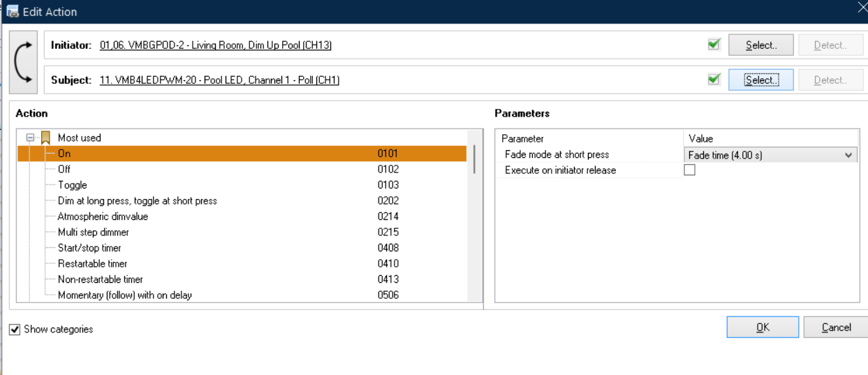

The LED strip installed in it\s final destination. Now I need to find how to make a nice fade in and fade out transitions. The dimming is so smooth, that I just have to do it… :heart_eyes:
I set up the fading in and out over 4 seconds. The effect is absolutely stunning :heart_eyes:
