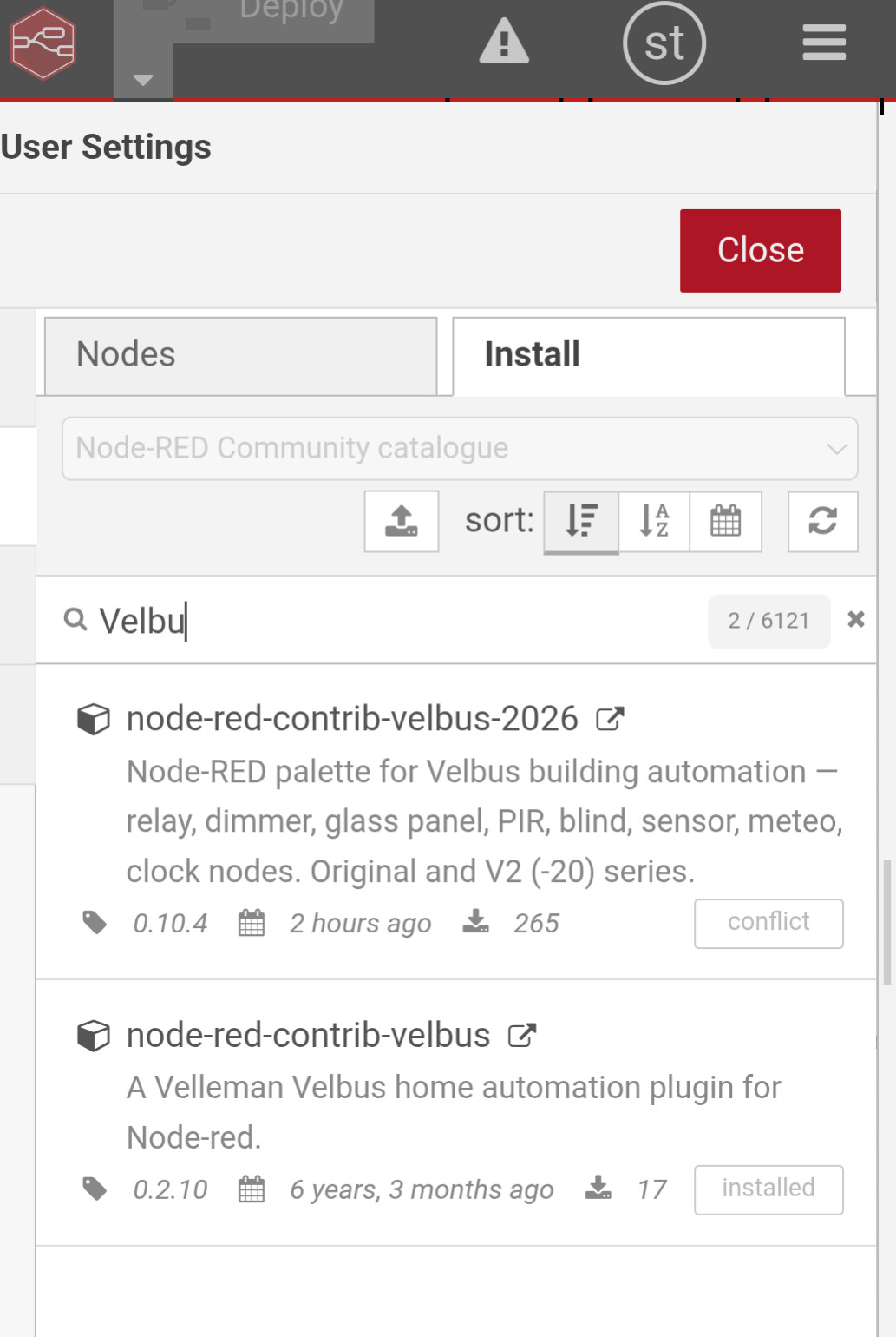

directly within the NodeRed palette manager
Just search for velbus-2026

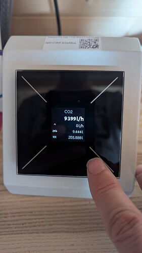

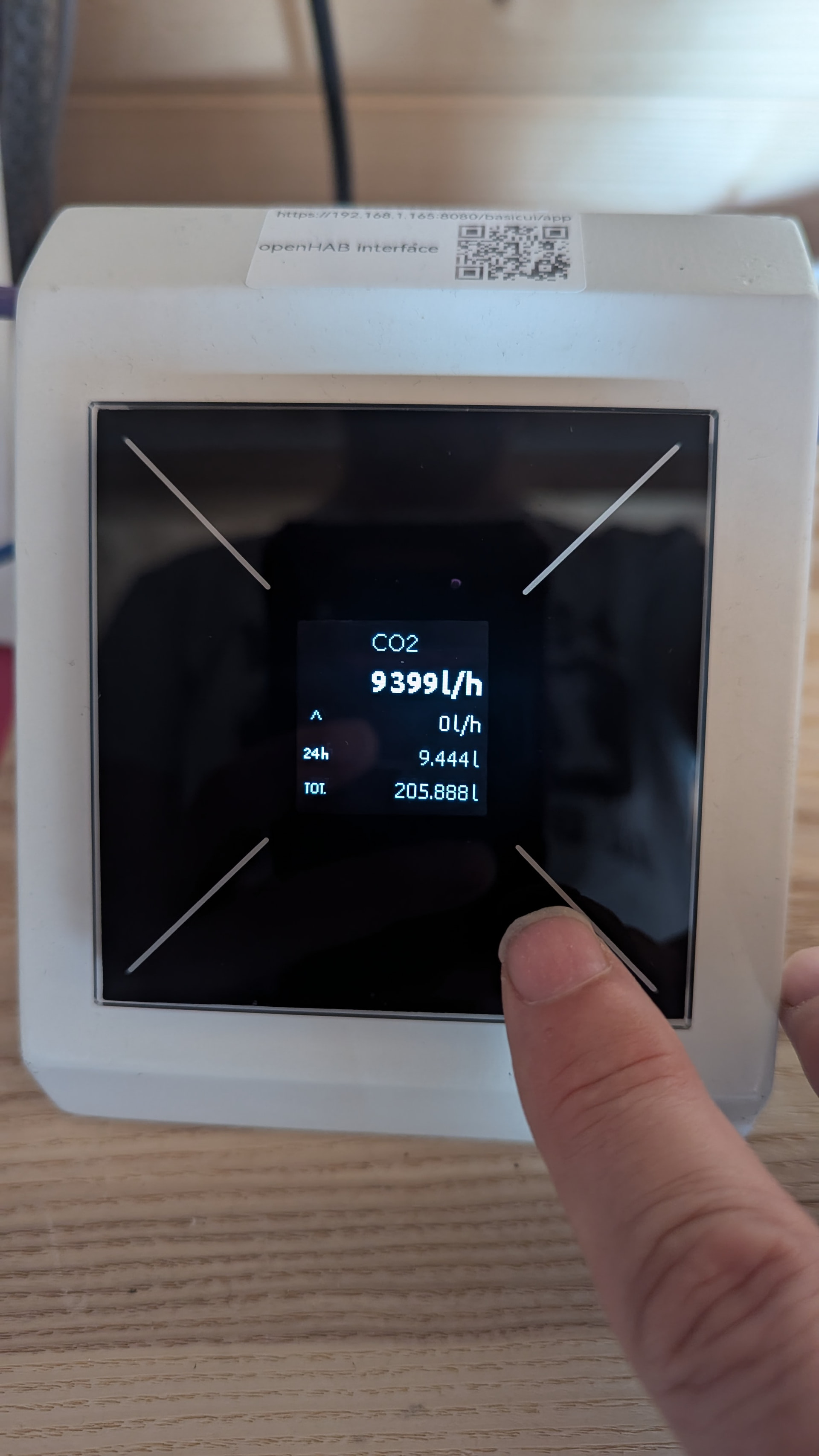

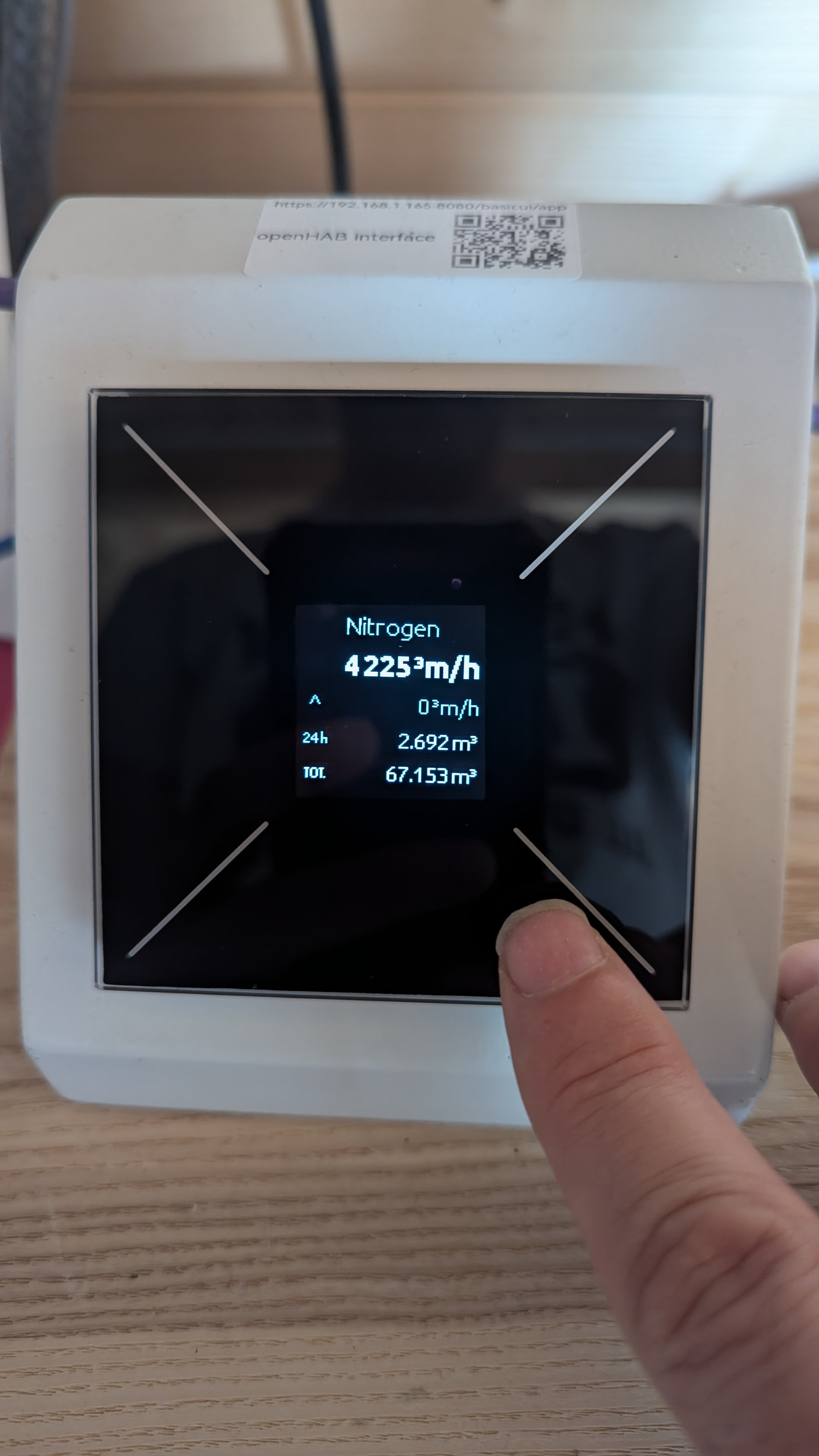

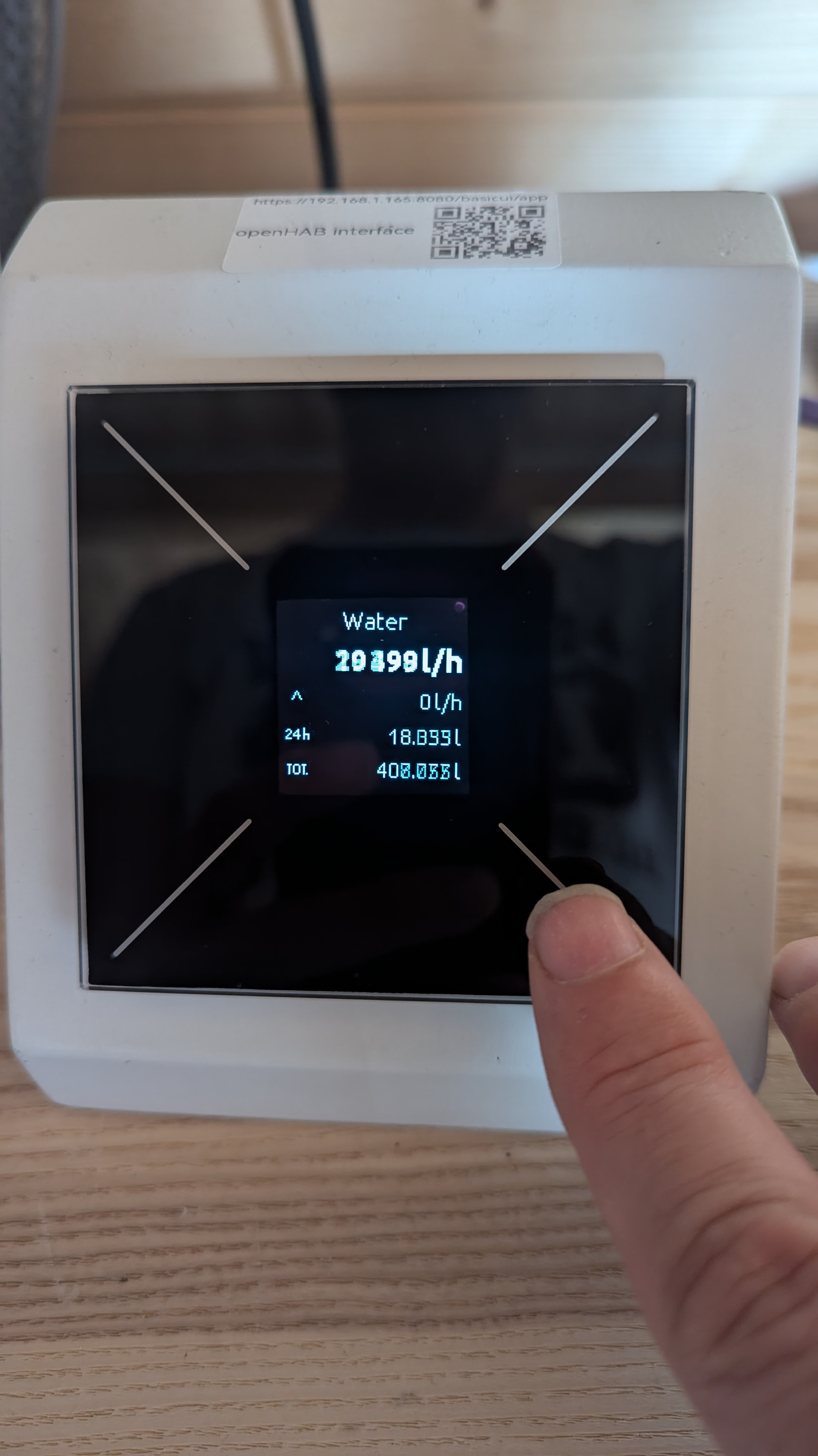

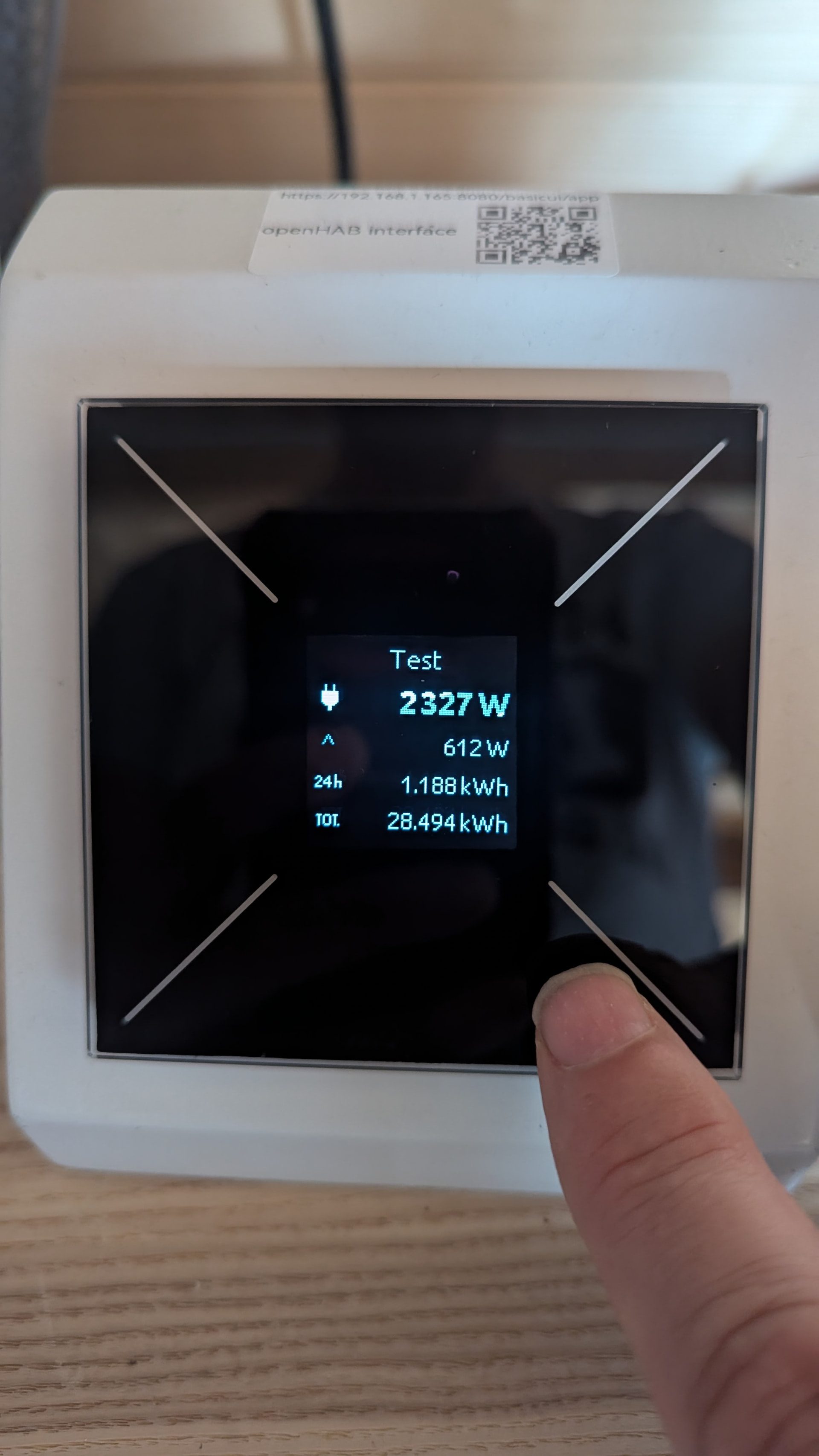

New: velbus-emulate-counter — third-party data onto the bus, displayed natively on OLED panels
The actual goal this whole evaluation was working towards: get third-party data (MQTT, Modbus, anything Node-RED can reach) onto the Velbus bus as a genuine module, so VelbusLink can assign it to a real OLED Counter page (VMBGPOD/VMBELO) and display it natively
— not a single scrolling Memo-Text banner.
Emulates a real VMB7IN (pulse-counting utility meter interface — confirmed genuinely generic across electricity/gas/water, same wire format for all three, distinguished only by configured scale and unit).
Real build number 2306 confirmed from a real installation, same discovery mechanism already proven for VMB4PB/VMB4DC.

And here it is
Listed in the palette manager
(July 9th 2026)

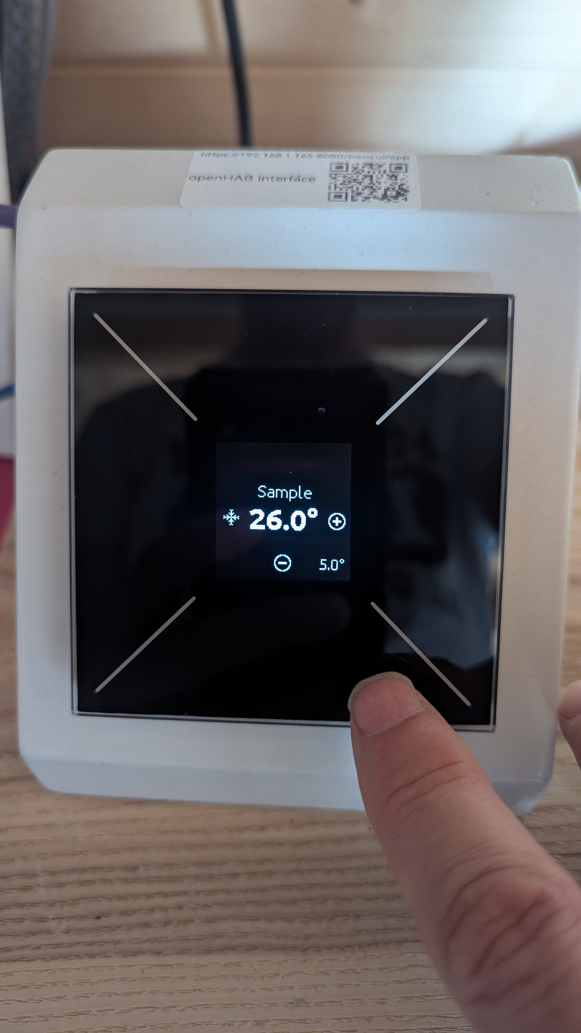

:new_button: New: Module emulators
Two new nodes let Node-RED pretend to be a real Velbus module on the bus —
useful for training, testing, and building against modules you don’t have on
the bench:
  • velbus-emulate-button-io — emulates a VMB4PB in I/O mode (4 button
    inputs + 4 open-collector outputs)
  • velbus-emulate-dimmer — emulates a VMB4DC (4-channel dimmer)
Both can be scanned, linked, and configured from VelbusLink exactly like
real hardware
, including:
  • Real memory read/write/dump (channel names, link configuration all persist)
  • Genuine reaction to VelbusLink-programmed links — button events on the bus
    correctly trigger On/Off/Toggle/Momentary/Forced actions on the emulated
    outputs, and long-press dimming on the emulated dimmer
  • Persistent forced-off state (sticks until cancelled, exactly like real
    hardware, including correctly showing as “Locked” in VelbusLink)
  • Configurable long-press dim speed per channel — not limited to real
    hardware’s fixed 4-or-8-second choice
  • Node-RED can also drive both directly (simulate button presses, set dim
    levels, or command outputs on/off/toggle/forced) for testing without any
    real bus traffic at all
