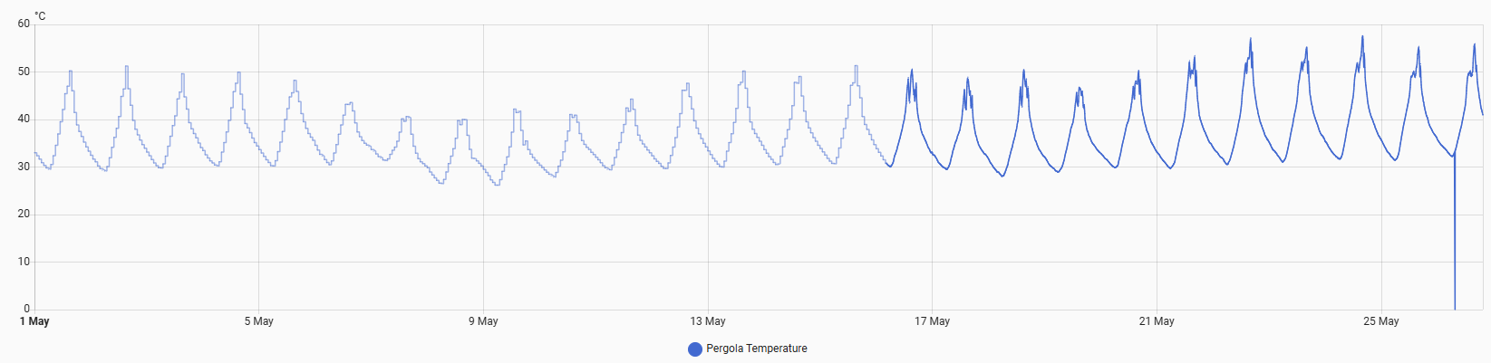

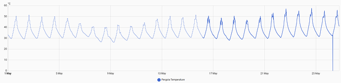

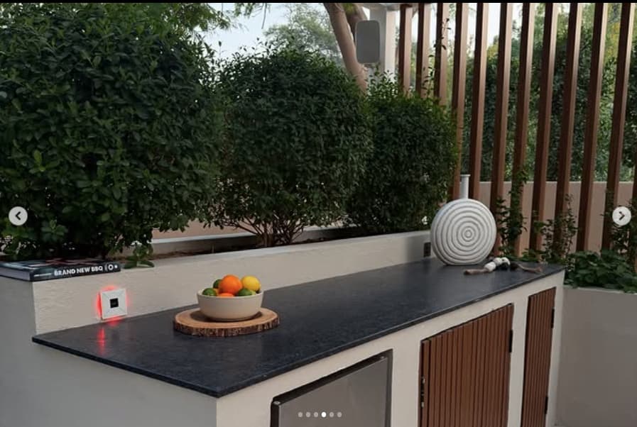

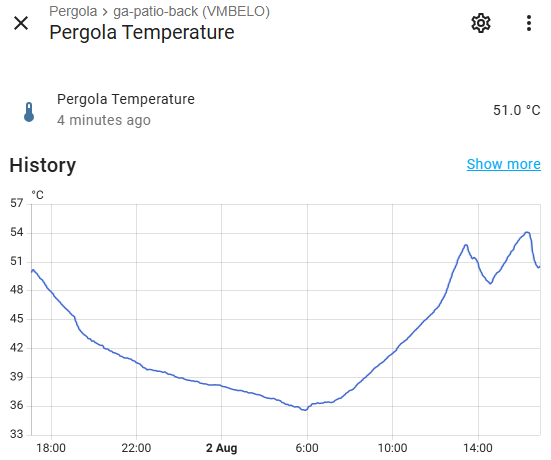

I’m running a VMBELO outside in pretty rough weather (although it almost never rains here and it has a rain cover anyway)
but to give you an idea of the weather
and so far it’s surviving… (not sure how long it will last)… another option is to run a normal switch (outdoor rated) with a Velbus input module
The only thing that ruined the setup during “winter” was that it was used as an ants nest at some point… which made all the lights go crazy… some powder and enabling a screensaver without direct control fixed that

heat wise… lets see if it survives this outdoor temp… (I guess I voided my 10yr warranty on this module)
