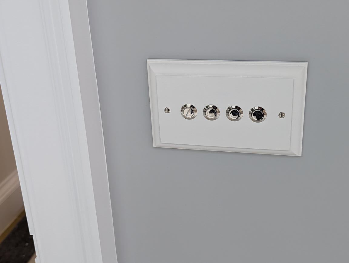

I know what you mean about the modern look of the glass panels. We used them on a previous project but they were not right for our current home…. so we made our own light switches. We have over 30 of these, some with four buttons and some with two. They have a velbus pushbutton module (VMB8PBU in our case) inside.
But we could not find a good velbus solution to replace thermostats (apart from the glass panels).
