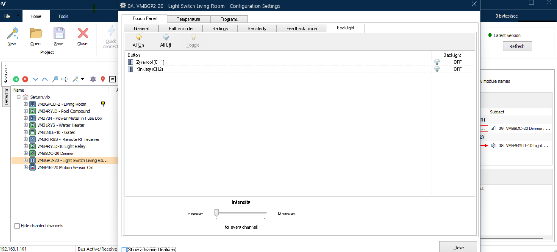

I use those settings, yet there backlight is ON: I tried to write not only changes, didn’t make any difference.

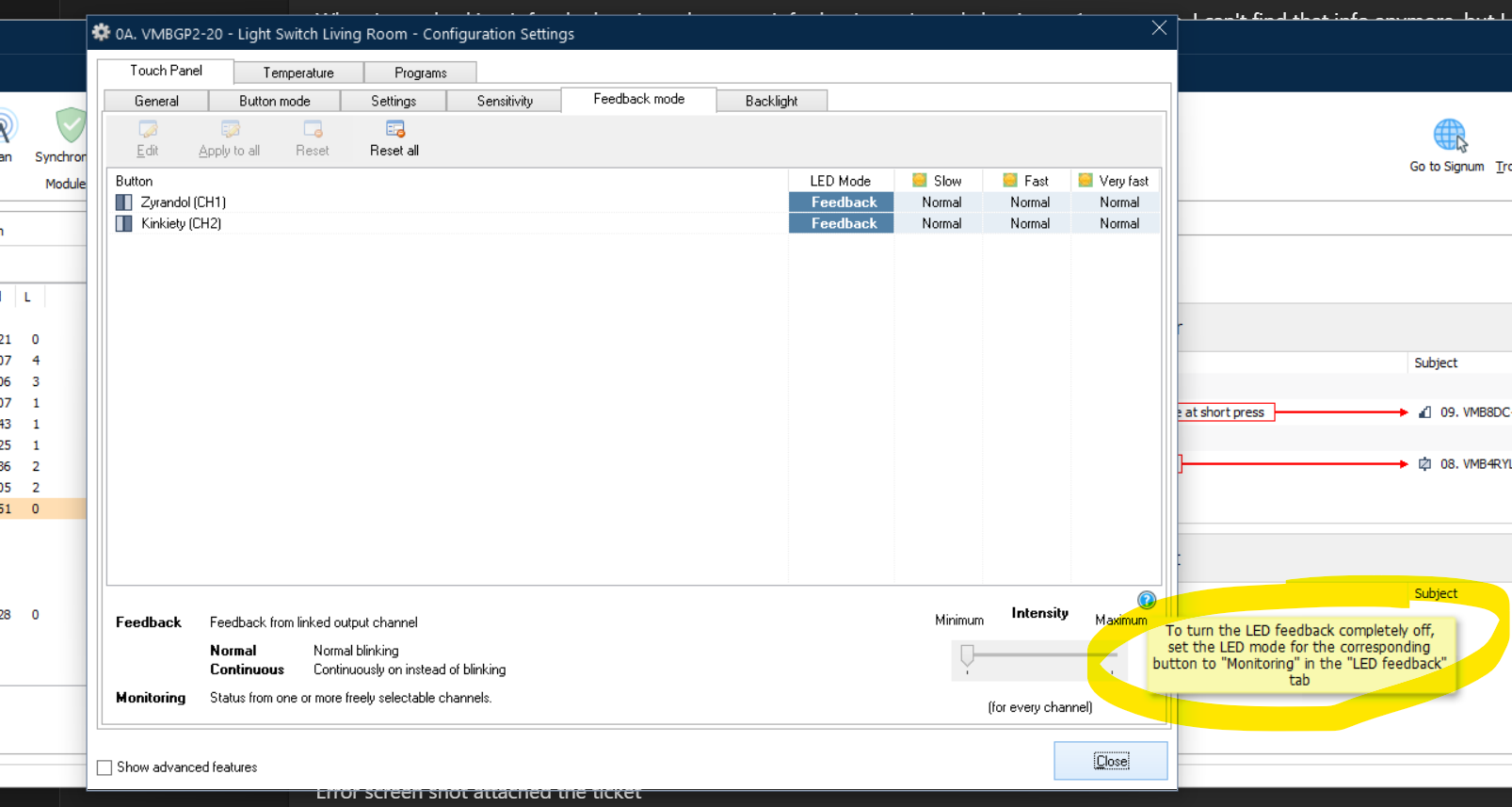

Configure ->Touch panel → General → Feedback mode → in the LED Mode, double click on Feedback and change it to Monitoring
Ambient? Wow, you got me confused now
. I can’t find anything that would have word ambient in the Settings. But I found this:
It allows to switch off the feedback completely and it works OK. But I need to switch off the backlight…
Thanks, but that’s feedback. I want the leds to be completely off. Like I have on gpod2. That doesn’t seem to be possible.The option is there (my opening post), but it doesn’t switch the leds off.
I’m 99.9% convinced I found a bug. Changing the intensity of backlight works, but not switching it off.

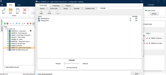

It works, but it doesn’t allow to switch the leds completely.
I can’t remember exactly what is on the Backlight tab, but OFF should be an option.
If the lights are still on, please do report it as a bug.

The option is there (see the snip in the first post), but it doesn’t work. Bug reported.

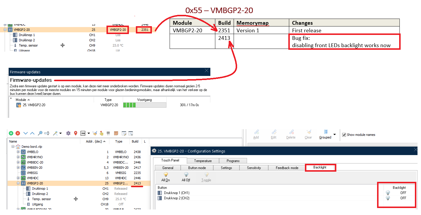

Hello @PrzemoF

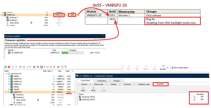

Please update your VMBGP2-20 module to latest firmware build: normally it will work to switch off the backlight (night indication).

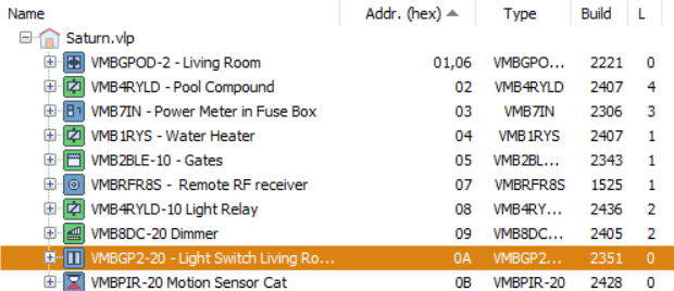

I’ve test it on new module with first release fw build 2351 (backlight off setting not working). Then
update to last FW build 2413, and it works correct.
Best regards,
Velbus SL2 - Tech Service
Firmware update solved the problem - thank you!!!
