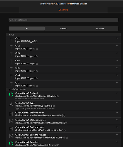

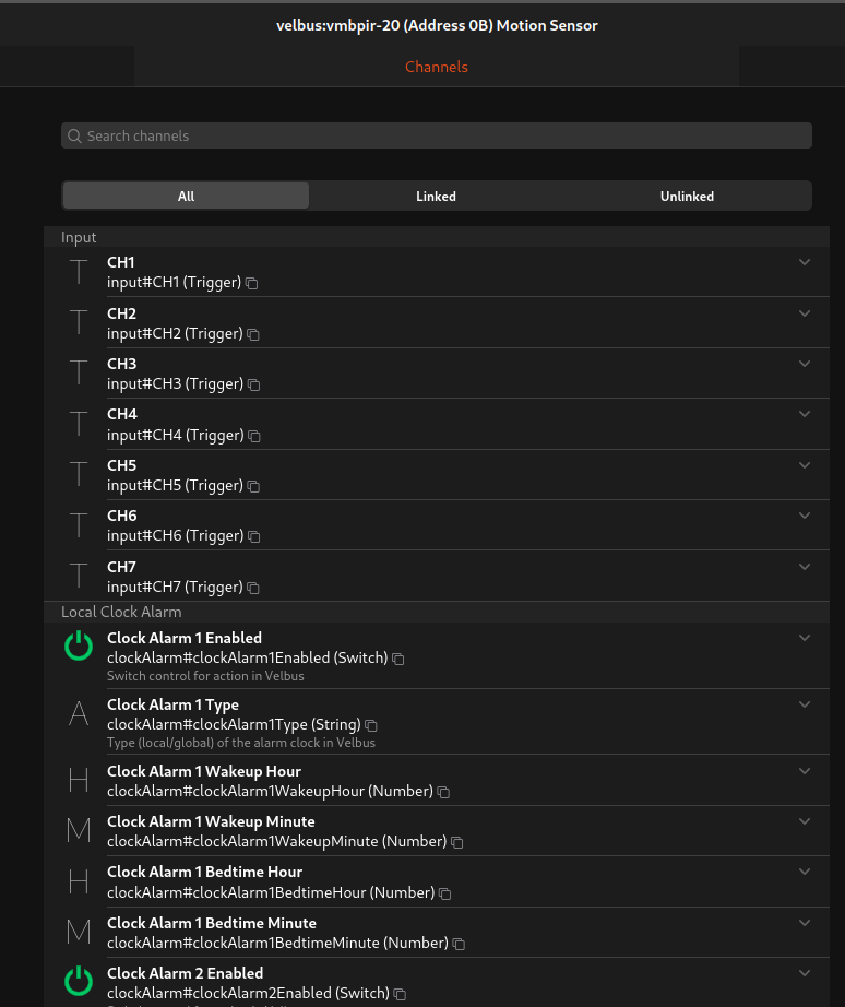

I got the PIR detector connected, address set… and in the VelbusLink I see the Motion, Light Dependant Motion, Absence, etc but in openHAB I only see Alarms and CH1 to Ch7 (inputs). Is the binding fully developed? Or it’s my local error / problem?
I have enough knowledge to dig into that, but I just wanted to make sure it’s supposed to be there (i.e. maybe I missed some configuration in VelbusLink)

PIR devices are basically the simple 8 channel profile.
You’ve got the triggers showing.
Consider the channel numbers, rather than look for names.

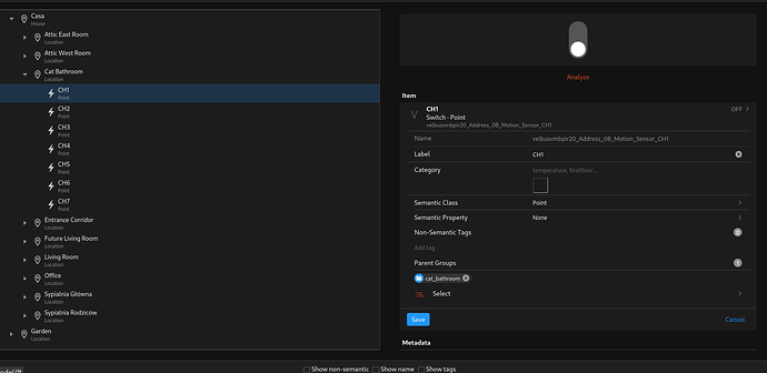

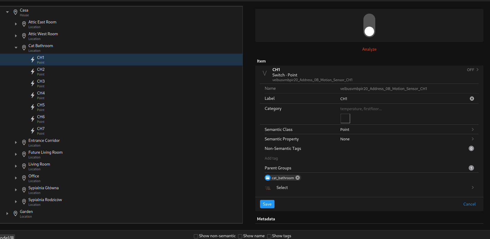

I’m probably over-thinking a simple problem. Can I set up OH so it shows me when the motion detector detects something? I’m going to trigger the start of extract fan in Velbus anyway, but I’d like to see the detected movement in OH as well. I tried to add new items (toggle switches) linked to the channels, but they don’t seem to show any activity. I created points from the channels - no activity.

Oh yeah, that’s super easy
Any rule engine you prefer, use the channel as a trigger and look for PRESSED or RELEASED
After that… Do whatever you want
Try creating a String Item if you want an Item to be the trigger

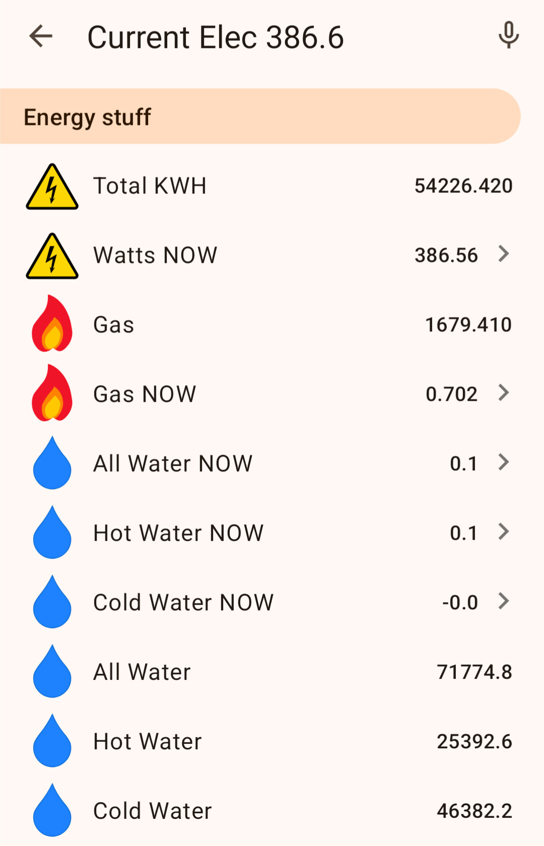

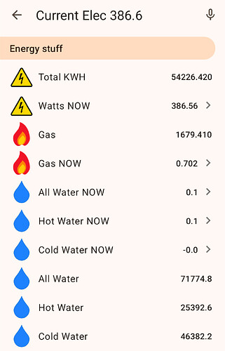

That’s definitely possible, this is ours
This has been working for years :laughing:
