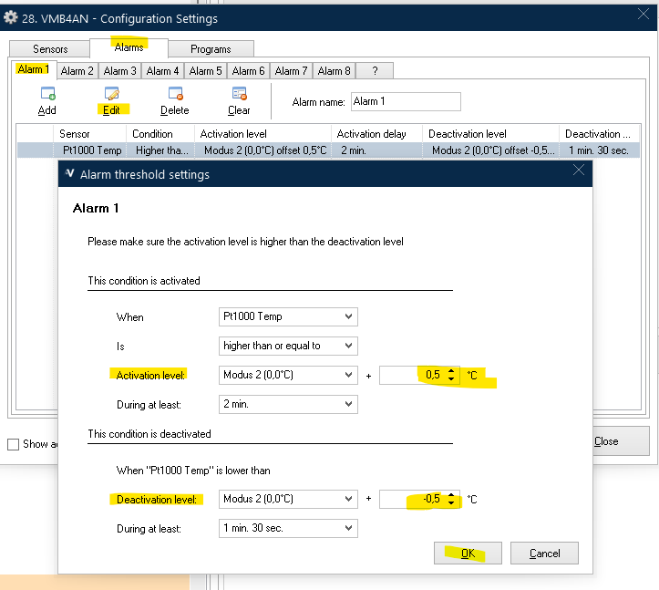

We have reproduced the situation with offset setting (hysteresis) and it works correctly for VMB4AN Firmware 2120.
See photo config hysteresis below.

Hi,
Thanks for the reply.
Unfortunately hysteresis config is not possible when using Active mode threshold
